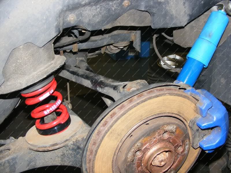

      Here are a few more pictures of the conversion
      H&R Coilovers as requested by the customer:
