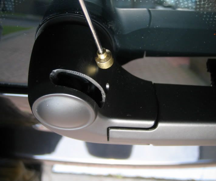

You just need to make the slot longer in the Audi cap for the water to come out....Very easy to do with a Dremmel...:)
agreed, if you look at your current rear wiper, look at the plastic cap and you can see where its open to allow the washer to spray onto the window. A few strikes from the Dremmel and you could fashion a similar opening, or widen the one thats already there (if it is there). should be as above basically.

Hi Tony, it was your fault that Audi A4 Avant wiper......credit to you fella. :wink: What I had to do was to drill several holes along the edge of the Audi cap and then using a stanley knife carefully cut along the edge on both sides. Then to finish off use a file and fine sand paper to smooth off edges. In case you are about to say....No I dont have a Dremmel but its on the Christmas list!:tongue:
Ps. I always wanted a Blue Peter badge :xD
See picture below :xD
