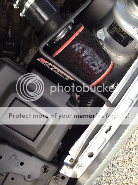

Finally got round to fitting my new gear stick, love it, has a much more grippy feel to it now rather than the greasy smooth finish of the 12 year old one.
+ Took delivery of my CAI Kit from R-Tech, feels a little less sluggish, and sounds better too : )
Now working on a cold air feed for it from the front lower grille.

I got round to making up my cold air feed today, I don't know if it'll even make any difference but hopefully it will.
This is only feeding cold air to within the heat shield, its not going into a closed box and being sucked in and I very rarely take the car out in the wet too so I can't see it ever being an issue.
The only thing I may do, is get a reasonably fine mesh to cover it just to stop too many flies going up there.
So I bought a RamAir duct and funnel off of ebay, which can be found here: http://www.ebay.co.uk/itm/Ramair-76mm-ID-x-1m-Black-Flexible-Cold-Air-Feed-Ducting-Intake-With-1-End-Cap-/391446877567?hash=item5b240d557f:g:vzQAAOSwY3RXJp2e
To fit, rather than remove the bumper I just took the battery out to gain easy access, you will need to modify the plastic trim that the original snorkel goes into.
Also, because I went cracking on with cutting out the hole in the grille, I did it in the wrong place :D ideally it wants to be closer to the temp sensor to clear the metal work behind, I did manage to make it work by temporarily removing the low tone horn (horn sounds a bit pathetic at the minute) I'll relocate when bumpers next off.
I'm sure someone will have a negative view, but it can be easily reversed if it does pick up excessive debris or draws any water.
also.. function over form ;)

You've been busy :) Are you not worried about the risk of running that air intake, or do you only run the car on dry days with no rain? I know of a few R32 engines killed by those things, two that come to mind are a guy that used to be a regular on the forums "Haf1zur", he broke an engine by sucking in water through a bumper intake. Alfie recently helped to break an R32 that suffered the same fate. Also my R32 (R18 conversion) was written off (which led to me buying it as a project) because the engine was broken by hydro-locking.
2,958 Posts
Yeh man, its a risk running that, Alfie and I broke the car for Colin.
Water sucked up, Hydro locked the rod and shot a 4" hole through the bottom end of block.
Not a very good Induction Set Up... :(
1,022 Posts
Discussion Starter · #54 ·
@FRANKO180 @MJVR6 sorry this computer doesn't let me quote.
but its not a 'suction pipe' its just channelling air into the heat shield area. I don't drive in the wet if I can help it anyways.
but I did get caught in a freak rain storm once, after the journey I checked the filter and it was bone dry, No water in the heat shield area at all. I was amazed, been on there for around 7k miles now, and the filter is still spotlessly clean. so all seems well.
those chaps that knackered the engine had one of those forge ram air kits I expect (or whichever brand they are), that sucked air up from low down
2,958 Posts
Shiiite set up..
