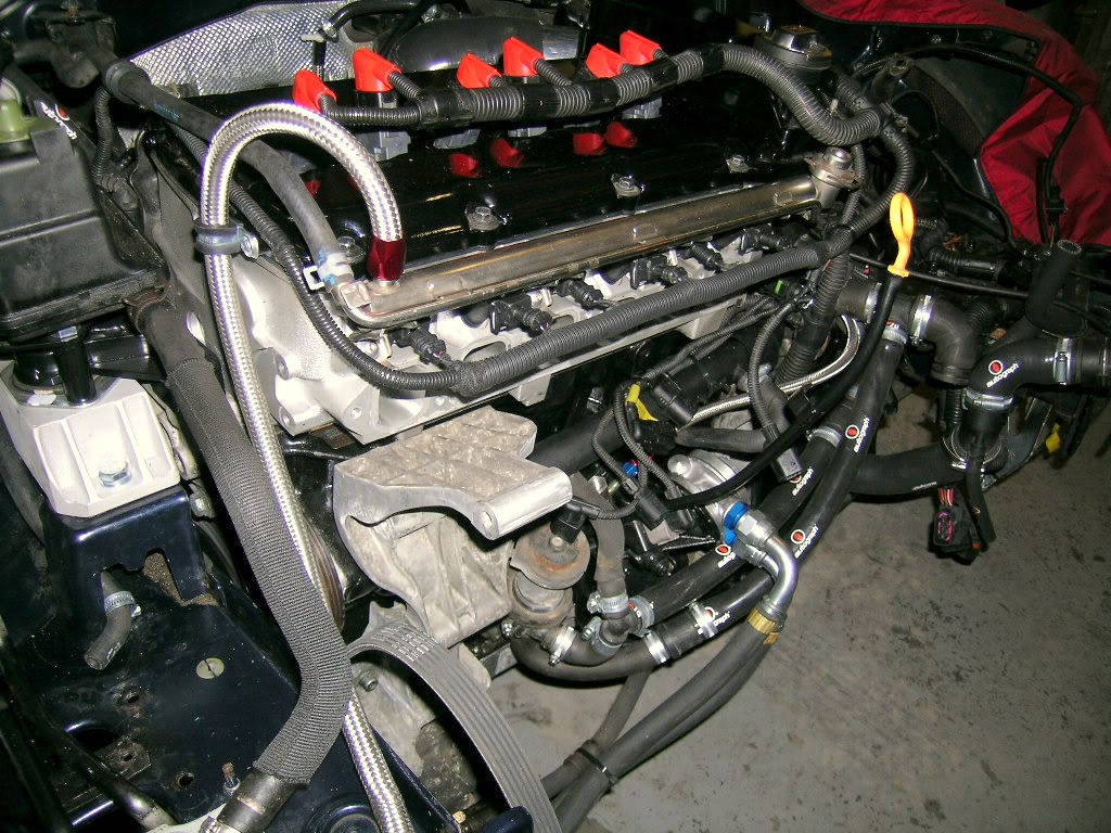

I've got a Mocul 25 row setup in my drivers front scoop with sandwich plate and stat.
Works ok for me and rarely gets over 100c on load.
Steve
Cheers Steve.
Did you keep your standard heat exchanger as well? Any chance you know the specs of the cooler such as the width? Also what length hoses did you use?
1,010 Posts
Cheers Steve.
Don't think the TT has a standard heat-exchanger for oil, or mine has been removed for that long I've forgotten.
Here is the 25 row I've got with 3/4 bps fittings.
The hoses were custom made at the shop and are about 3ft long..
http://www.burtonpower.com/mocal-oil-cooler-radiator-25-row-3-4-bsp-mococ5253-12.html
You can just see where the cooler if fitted and hoses..
Steve
