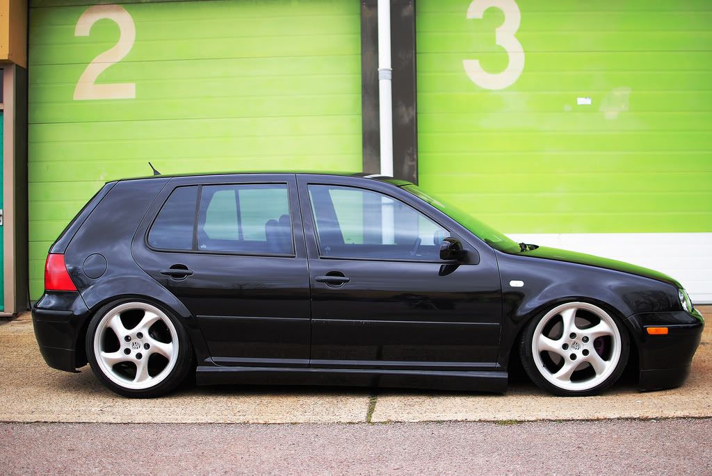

I'll dig out some pics of mine, you won't need to roll te rear arches. On the rear of a mk4 there's no lip to roll, only flaring if you want to get it painted after.
You'll just a healthy stretch and to work the offsets out well.
It'll probably end up being a 225 on a 10 inch rim
269 Posts
My mate has Turbo II twists on his mk4. If I remember right he had the arches rolled but not to much effect as someone has already mentioned. 8.5J and 10J front and back respectively.
Wheel Tire Bicycle Car Vehicle
