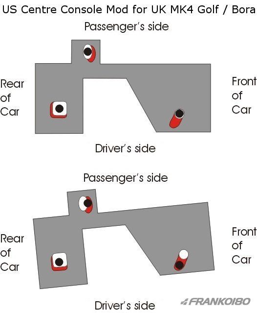

So since I'd stripped the car's interior out for the clean up in 2013, I'd not had a centre console installed in the car. I bought a couple of US centre consoles a few years ago, one for was supposed to go in the Bora, but still hasn't been installed yet.
For anyone that hasn't seen one, the advantage of the US centre console is that it has two extra cup holders in the centre. To make space for the cup holders, the handbrake is re-positioned to face towards the passenger side seat, this way it is not covering the centre "area" of the console, so it is not covering the place where the drinks would be stored. For the US drivers, this is no problem as they sit in the left front seat and can reach down with their right hand to operate the hand brake, even if it is close to the right of their seat as their hand is on the right side of the handle. But for a UK right hand drive car, if the hand brake handle is near to the passenger seat then its a little less easy to squeeze your left hand into the gap between the handbrake and the passenger seat.
In a UK car it's a compromise, the cup holders are really useful, but the position of the handbrake right over towards the passenger seat is not ideal. Anyway, if going ahead with a US console install, the handbrake needs to be positioned to point towards the passenger seat. To do this there are two options, one is to get a US specific handbrake mechanism that has mount points on it re-positioned so that it angles the handbrake towards the left front seat, or the existing handbrake can be modified by enlarging the mounting points so when it is bolted down to the car, it can be angled to the left.
The diagram below is one from a US forum that I've slightly modified just to make it more clear for UK cars.
The pic below is my original UK handbrake unmodified, looking central. In this position it would be a nuisance for a US centre console, it would cover the cup holders, not only that but the handbrake needs to point to the left or the US console won't fit over it properly as the handbrake opening is angled.

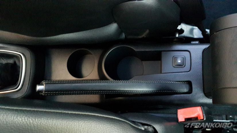

Here is a standard handbrake on the left and a modified handbrake on the right (both viewed from underneath)
US console installed, notice the handbrake is pointing left
I fitted an armrest during this install, for anyone with an armrest, theres are the two trim piece part numbers for if you want to replace them:
1J0 864 279 B 2QL (left side)
1J0 864 280 A 2QL (right side)
Arm rest in place (I've got one that is in better condition but just fitted this one to try it out).
View of the handbrake from above, (The seats were probably slid out of normal position for this photo)
Another view of the handbrake from above. In this install I'm using a modified UK handbrake mechanism but it isn't perfect and the handbrake still needs to go further towards the passenger seat to allow it to move freely without fouling on the US console.

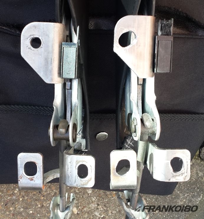

Here is a comparison of a genuine standard "UK" hand brake mech along with an OEM "US Console" handbrake mech.
Part number is: 1JM711303B01C

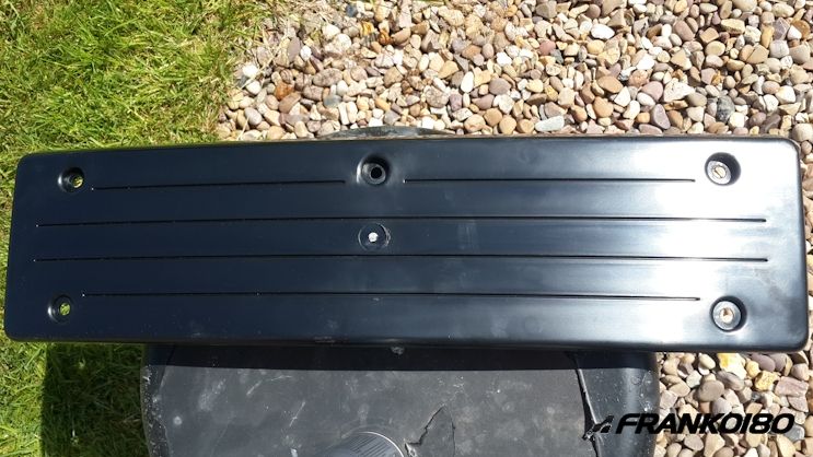

Not really a big change, but if nothing else the part numbers might help someone. So I'd been driving the car with the number plate stuck directly to the front of the bumper. It looked okay at first:
But it didn't stay flat on the bumper and started to curl out at the edges. I know a lot of people like the "clean" look and don't want the OEM number plate plinth but the car was looking a bit off with the number plate bending like that, also I'm not trying to go for a show car look, I'm happy with the standard factory look.
So I got a new plinth from VW and as only the edges are visible when the reg plate is fixed I decided to paint it myself, the plan was to paint it and lacquer it.
Put the plinth in the "spray booth" (knackered chair on the garden). Everything went well..
Until a random leaf blew across the garden and of all the possible places to land it landed on the plinth when the paint was still tacky.
Total fail!
So got busy with some very fine sandpaper and flatted it back, got rid of any dust and did it again and managed to get away with it, couldn't see any problem after the second go.
As promised for anyone finding this on google etc, part numbers for the R32 plinth and it's fixings:
R32 number plate plinth 1J0807287AB41
R32 number plate plinth rivets SN0385491

Got the plinth fitted..

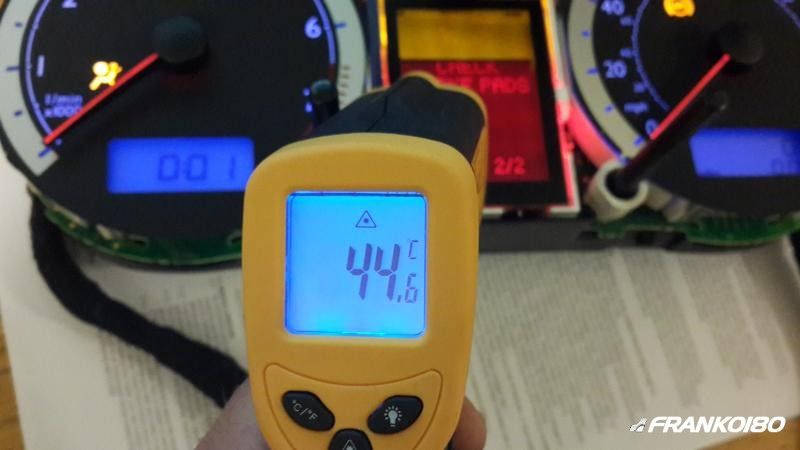

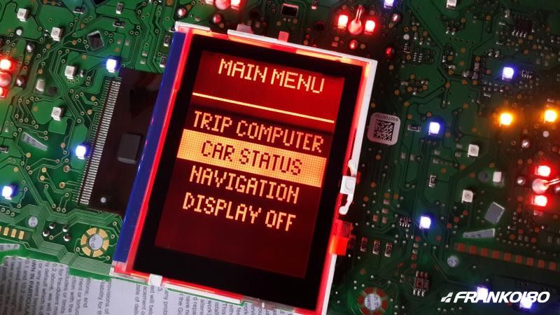

Bora Sport / Golf Anniversary full FIS cluster repair of faded / aged LCD - 256000 miles
Confirming bad screen fade at over 30C which is a typical temperature range when the cluster is warmed up on on a sunny day.
New LCD installed...
And tested at over 40C
Cluster fully rebuilt, "Miles to empty" fuel range feature enabled and always lit needles enabled

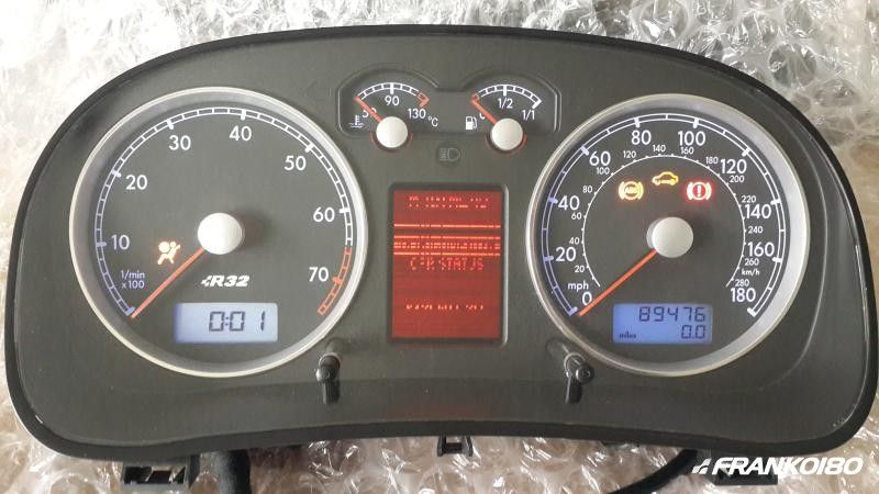

R32 full FIS cluster repair of bad lines display, 89000 miles (same fault often seen in MK1 Audi TT clusters):
Repair complete:
