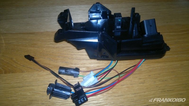

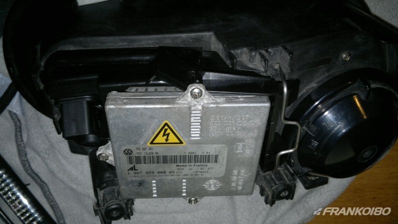

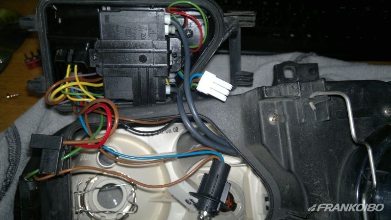

So I sourced a set of OEM R32 xenons, which were in half decent condition not as bad as some garbage I've been sold before, but I wasn't entirely happy with them but there weren't many available at the time. They were pretty clean but had been allowed to get some condensation in them which had pooled slightly and left some little water marks on the inside of the glass. Not terrible though, no dust/flies inside them.

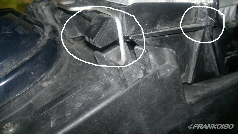

What did need doing was to replace the rear sections with the wiring in, I've seen this a few times before where the plastic cracks due to the clamping force from the metal retainer. The plastic gives up, the hooks can crack and then theres barely any clamping on the rear cover and all sorts of rubbish gets into the headlights. I repaired these, but in reality I knew to keep looking for some better ones that hadn't had the condensation issue (OK a bit OCD with this one).
So some of the common places the backing on the R32 headlamps fail, mine were fractured.

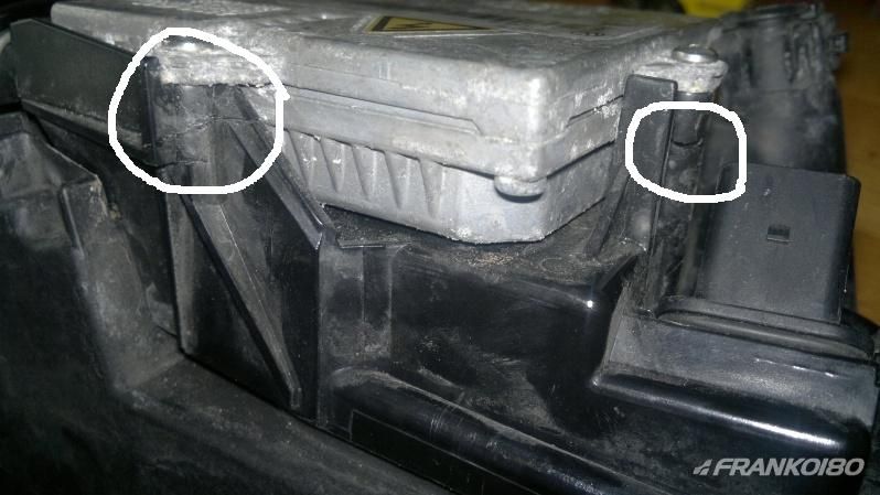

The left 'ring' on the pic below shows another place where they can crack, which stops the cover from clamping on.
Fitted the new rear covers to both headlamps

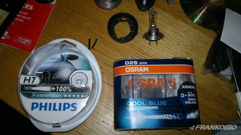

Didn't know what state the OEM bulbs were in, but assumed they might be past their best. Philips X-tremeVision H7 and Osram Xenarc D2S bulbs went in.
Done

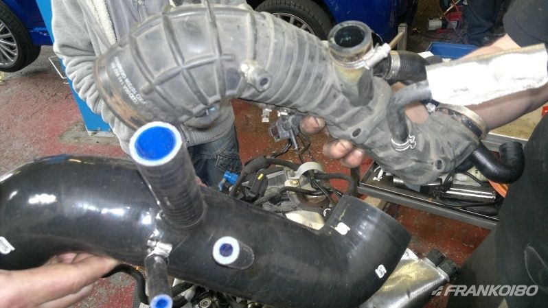

Engine goodies: oversize "Badger 5" Turbo inlet pipe. This picture is misleading, the black TIP is much bigger than the standard item at the top, much more capacity to flow.

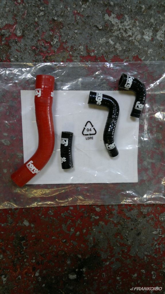

Engine goodies: a few forge hoses to uprate dodgy rubber breather hoses which would eventually perish and split. Had no choice but to get that red one, at the time Forge didn't offer a black version, forcing me to buy a McDonalds car park chav red special. Gits.

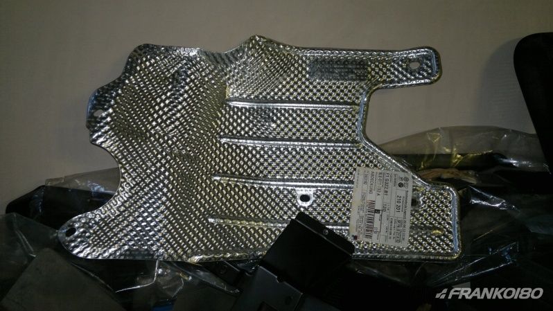

Engine goodies: OEM Heatshield

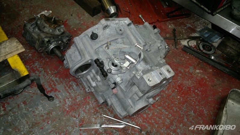

Gearbox (cleaned up), transfer box:
So a key part of this build, the wizard that is Gaz Jones at VAG Auto Care Services.
http://www.vagautocareservices.co.uk/
Gaz is well known on this forum but for those who don't know him, he's the "go to" guy for R32 servicing / repairs / upgrades / modifictions - HGP/HPA turbo installs, cam chain swaps, brake / suspension upgrades, fault finding, you name it. He's been doing the mechanical servicing on my cars for years now and this is not the first engine transplant he's done for me. But secretly I think this was a bit of a reluctant job in some ways, Gaz is not the biggest fan of 1.8T engines, but of course is a pro, so took this job on, but like other people was thinking "1.8T in an R32??"

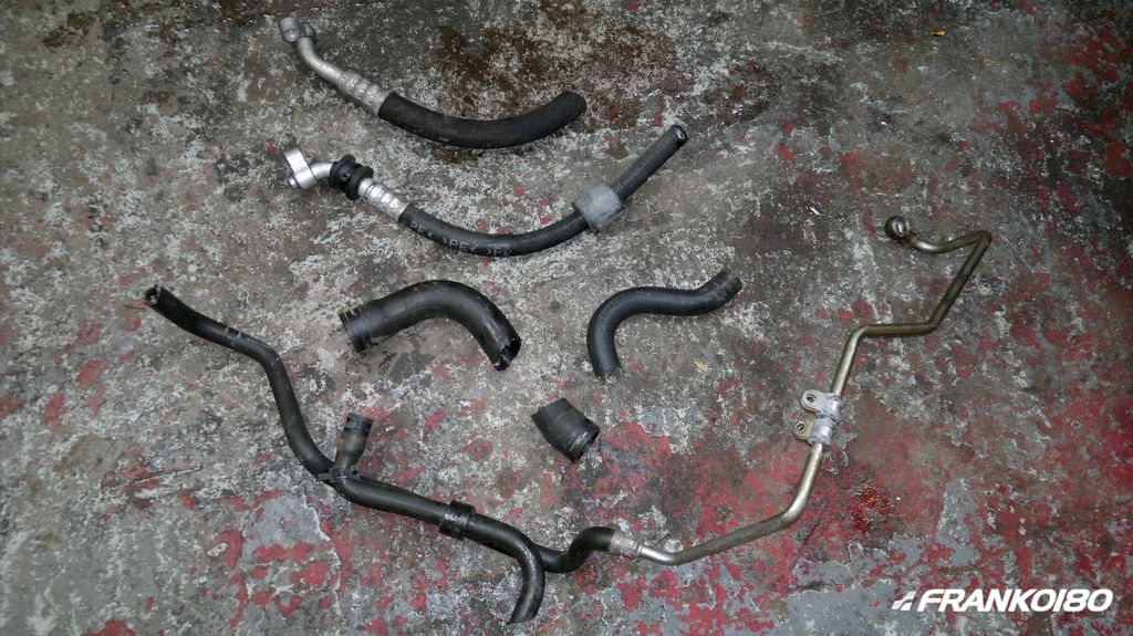

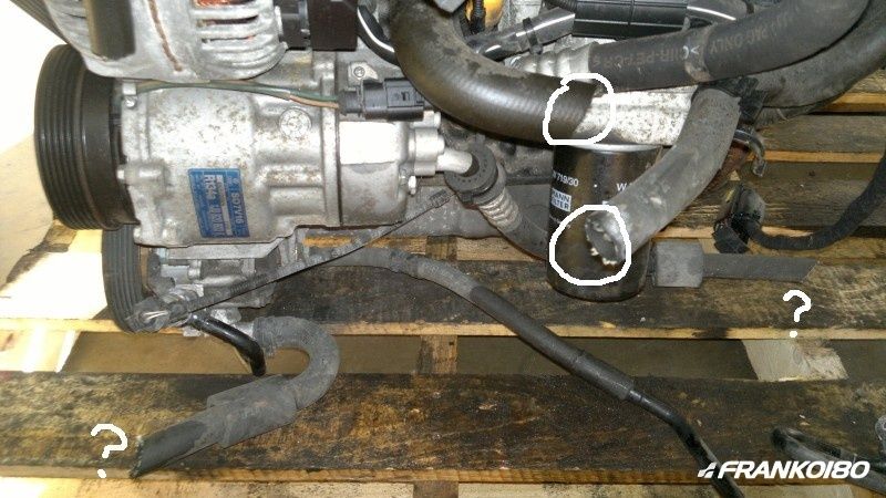

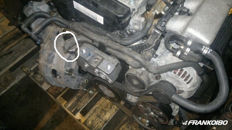

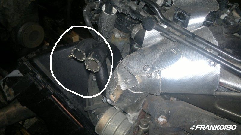

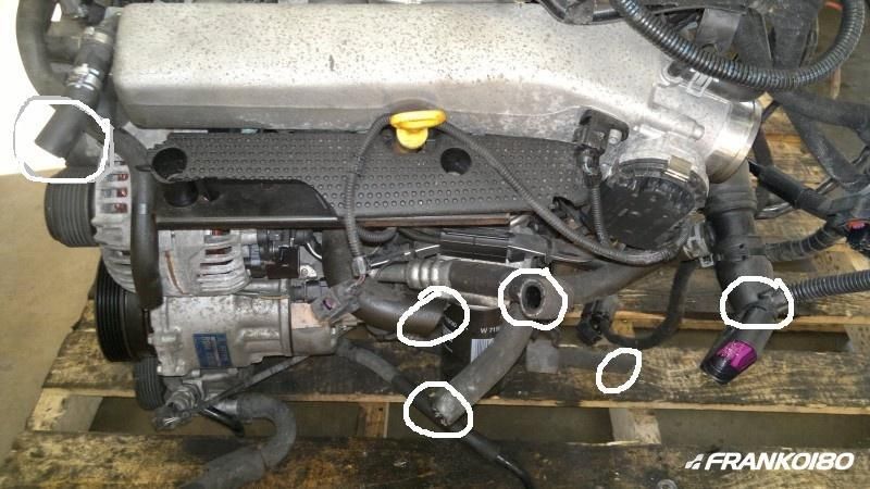

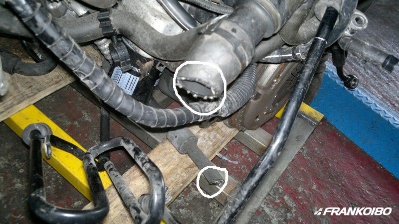

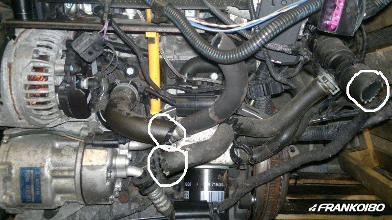

Whilst I was tidying the car up and doing some interior/electrical jobs on the car at home, I'd had the 1.8T delivered to Gaz so we could get that prepared and do some work before the car was taken there. First problem was that even though the engine was a beauty (low mileage, very clean from a late MY car) the cavemen breakers and gone around the block chopping hoses prior to removing it from the source car, so we had to work out what was chopped and then start a mission to work out what was needed to be replaced and source a bunch of hoses. Fun, a lot of trips to breakers for me and the odd VW order too.
So Gaz took some of the cut hoses off so I could take them to match up with any I could find/buy.

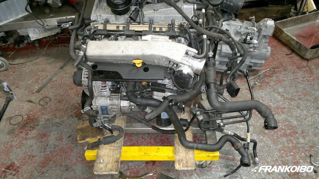

Engine waiting for hose replacements
