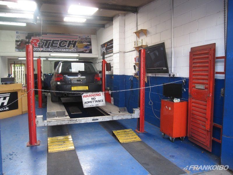

Yeah was a good day out, the rolling road had cars on it from 9 am till gone 6 pm, but I had to leave before the end so didn't see some of the late arrivals such as Farmer and Kieran doing their runs. This engine (so far) seems very healthy, it's a really low mileage lump pulled from a 2004 car (29k), so that's why it had no trouble making those figures.
The graph has the wobbly curve as the standard map has the "Torque Interventions" as standard on the ME7 ECU mapping. After seeing this curve and knowing the 1.8T / K04 has more to give, I booked it in with R-Tech for a remap to also include TIV reduction, to smooth the curve and unlock more power. Updates to come..

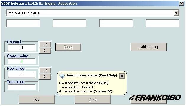

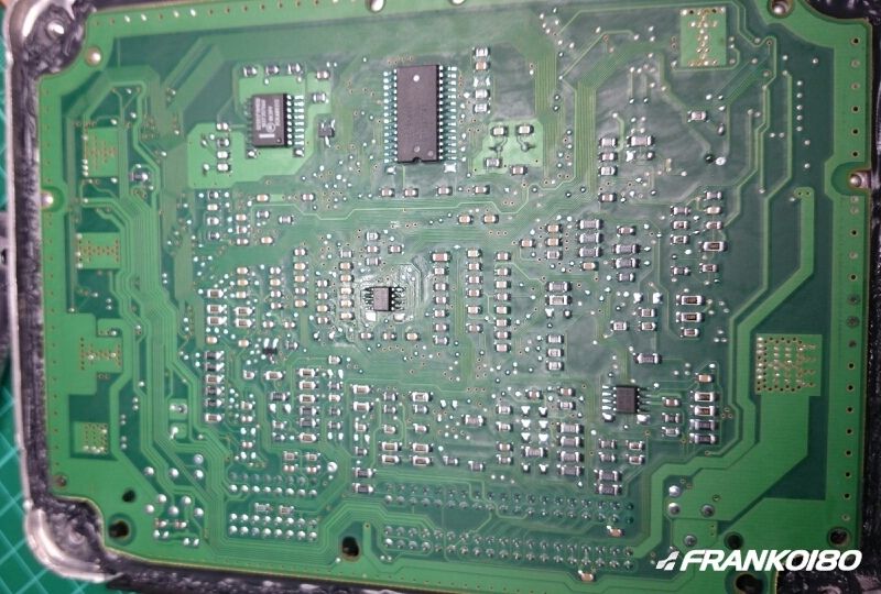

Quite a while later when the car was on the road I contacted a really helpful guy, Tom Walters (he has a user ID on UK-MKIVS of "A3Audi" - http://uk-mkivs.net/user/71705-a3audi/) who said he could re-instate the Immobiliser. He did a great job, personally came to visit the car and assess if he could code it back in but couldn't. He confirmed our suspicions that the immobiliser chip had some type of corruption/hardware issue and then we removed the ECU and he took it away with him to do some bench work on it.
It's a little while ago now and I was away from home a lot back then, so my memory is a bit fuzzy of what happened, but I think to resolve this problem Tom decided the immobiliser chip was toasted and he replaced it with a new chip and then loaded the chip with a default Audi configuration file and then programmed in my immobiliser data.
The photo below shows the ECU split open and the central chip that Tom replaced/reprogrammed.
When Tom returned the ECU it was plug and play, so we could install the ECU, turn the key and it was all good to go. The Immobiliser key symbol illuminated briefly on ignition and went out as it should. A final check was to query the immobiliser on VCDS and check the status, 4 = Immobiliser matched. I'd 100% recommend Tom for anyone in the Midlands with any ECU/immobiliser coding issues, he's helped a couple of people that I sent his way after he did my car.

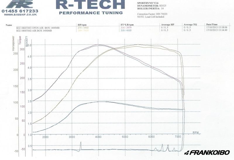

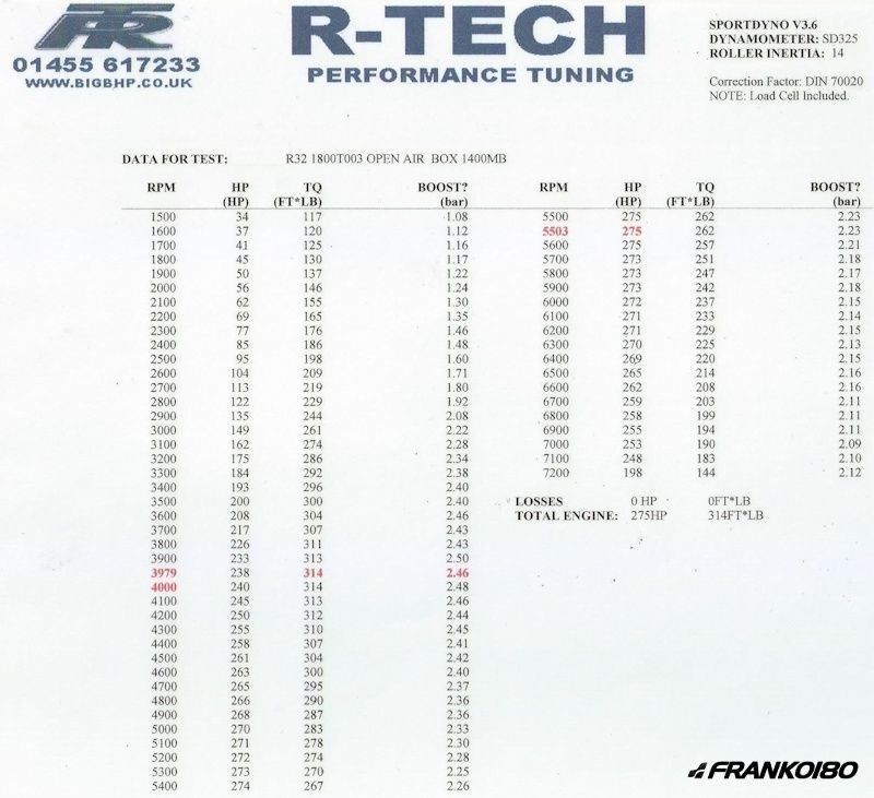

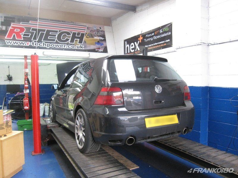

So the best peak figures it made at R-Tech for the remap:
275 BHP
314 FT/LBS
The peak run was done with an open airbox as Nick was not happy with the closed airbox and panel filter and, so real world with a closed airbox it's probably 270 BHP. Personally I'm not sure if it's worth having that vacuum cleaner sucking sound from a cone air filter just to get 5 BHP.
The car does need a FMIC because even though it made fairly decent power, Nick was saying that due to heat the mapping is tailored to not hold those peak figures for long and they could be sustained for longer / higher revs with a better set up, so that's something for the future. Can see from the graph below it makes good peak torque but in it's current tune doesn't hold it for too long for safety.
The result at this level of tune is that it does have some really smooth pull from that torque and is a giggle, especially on cold / winter nights, it goes pretty well when it comes on boost. Have to remember this is the "sensible" daily, so it'll do for now

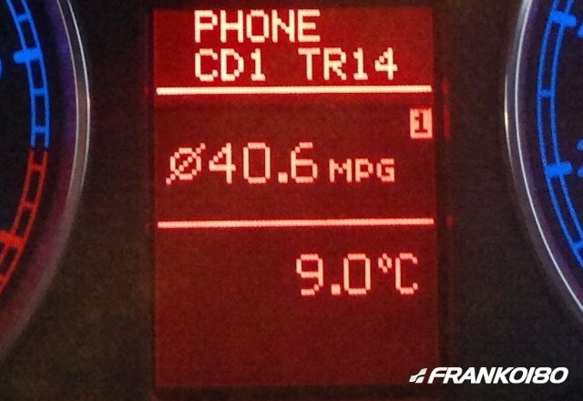

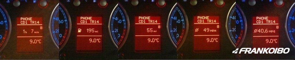

I know nobody buys an R32 for economy but since this car is a bit "different" by running an S3/TT 1.8T engine, I thought I'd share a bit about it's economy.This car isn't a TDi or a 1.4 eco car, but here is the "economy" I've noticed when on the odd motorway run. I wasn't driving to be especially economical, but also wasn't driving trying to set land speed records either, just at the speed limit where possible.
Journey A (Friday motorway traffic - couldn't get over 70 even if I wanted to, bit of stop start on the M1 a couple of times)
1 hour 7 minute journey, 55 miles covered, average speed 49 MPH, MPG = 40.6

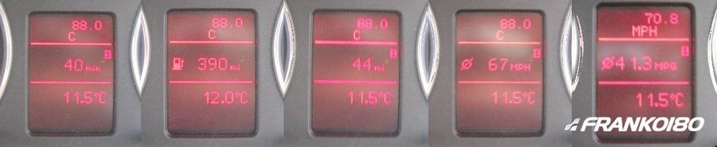

Journey B (more normal motorway journey, no hold ups)
40 minute journey, 44 miles covered, average speed 67 MPH, MPG = 41.3

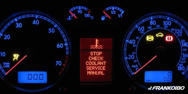

If you read all of this build thread you might have seen earlier my earlier comment about installing a full FIS (and replacing the faded centre LCD). I've seen a few comments on this forum and on other forums before where people just don't "get" the purpose of the Golf MK4 / Bora full FIS instrument clusters compared to standard clusters. I remember seeing comments on another forum advising other people not to buy them because they are "not worth it", even interrupting sales threads to say to others "don't bother". Harsh! Depends on what you are into I guess, if it's just a "show" style car that doesn't get driven that much then fair enough.
I know plenty of people on here have seen full FIS clusters before, but there are always people relatively new to the MK4 Golf / Bora, so here is a bit of a run down on what a full FIS can offer you that half FIS can't.

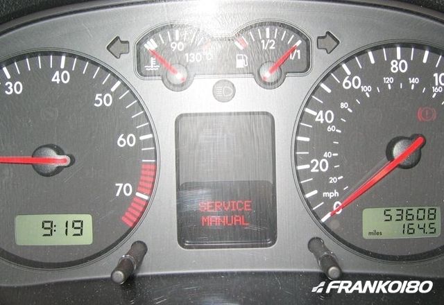

So a standard Golf MK4 cluster looks like this -
As the MK4 platform is dating back to the late 1990s the standard type half height cluster LCD centre screen looks pretty basic compared to the displays in modern cars, a full FIS cluster can help to bring it up to date.

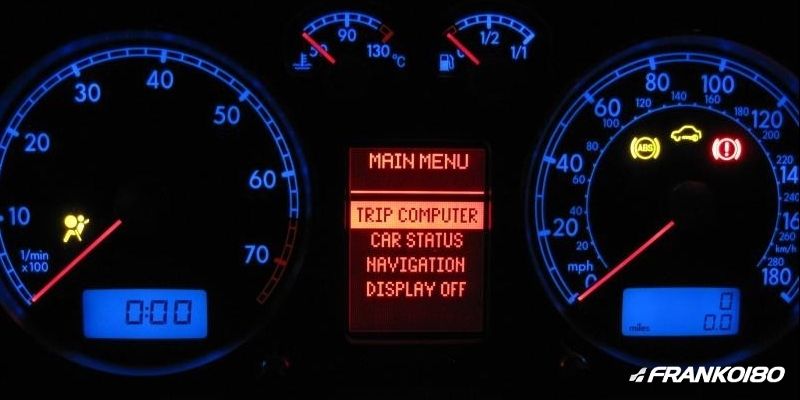

The basics - FIS menu

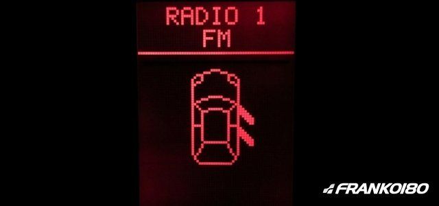

Basics - open door display (depending on if your CCM supports it and if you have enough doors

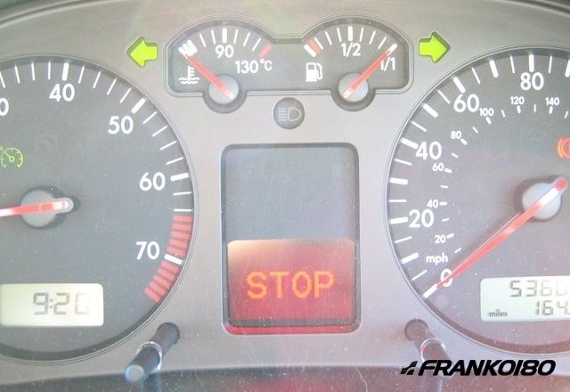

General warnings (some of which you don't want to see usually, there are more including oil level / pressure amongst others, luckily I've not seen one of those for a long time..)

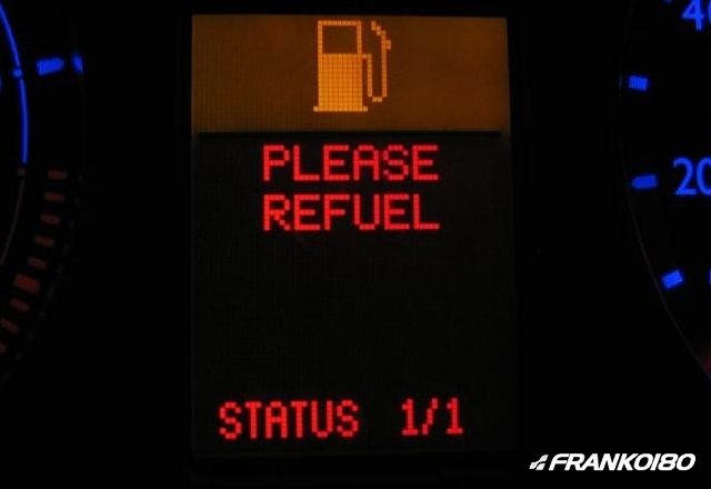

Fuel

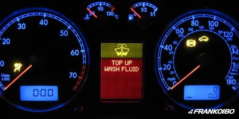

Washer fluid

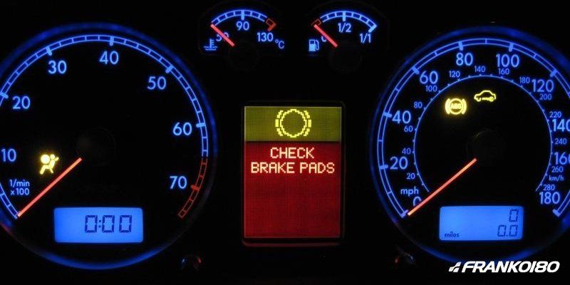

Brake pads
Coolant / cooling system

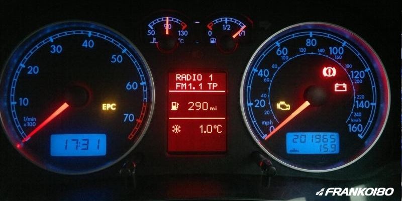

If an OEM radio is connected then the FIS LCD can display the radio station or CD / track number being played.

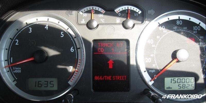

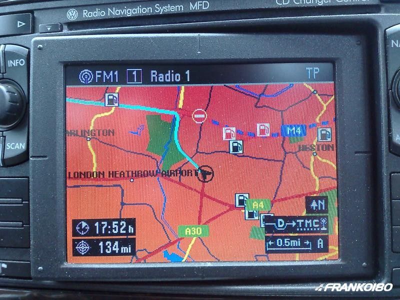

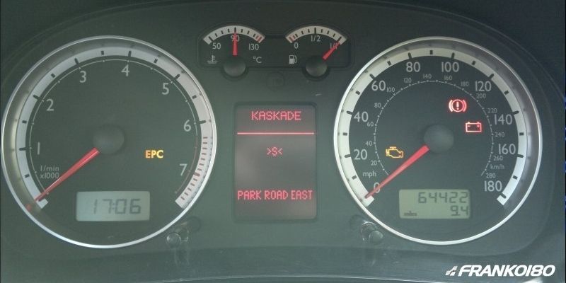

OEM VW MFD satellite navigation, which displays some of the route information on the FIS (and CD / Track number), as below:
(Bora sport 160 mph)

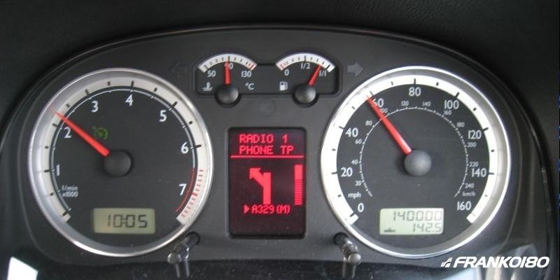

OEM VW satellite navigation can display bars that indicate at which moment to turn, along with spoken directions given by the headunit
The MFD was really handy as I had the TMC unit connected to it, it was combined with a TMC enabled navigation CD so the MFD could receive traffic updates and adjust the route automatically to avoid traffic delays

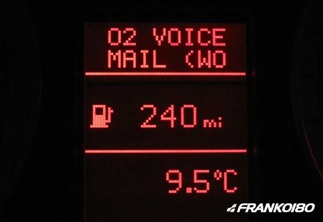

If your OEM head unit has some type of phone kit enabled with the "mute" line wired in, when the phone kit is active the radio will be muted and the display will indicate "PHONE".

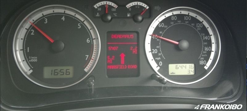

Compass (with MP3 song title above it). The Compass is not that useful usually, but available if needed.
(Bora sport 180 mph)
MP3 track and navigation - again if the head unit supports it (has to be an OEM not an after market) the MP3 track name can be displayed along with route guidance
So I think what it comes down to is that for those people that moan about / don't understand the full FIS display, they probably never connected anything external to it, I guess it would be similar to someone buying a new fancy LED TV but not connecting anything to it and then moaning about it
. It probably also depends how much you drive and if having extra information displayed is useful or not. My car is a daily and gets driven all over the place so it's pretty useful for me. Hope that helps anyone wondering if a FIS cluster is worth having or not
