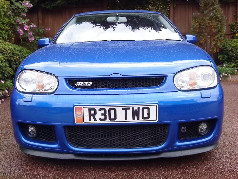

Finally got my fog lights fitted to my car after alot of mucking about with them got a few minor adjustments to do with the horn sounders but alls good need to get matching lamps to the headlights if anyone can hed me in the right direction but heres a few pics
the night shots a bit glarey will try for a better 1 when i find camera instead of phone

Looks good Nick :) glad to see you got them on, well done mate
Paul
Wow Nick looks very nice indeed.
Thanks for the picture message that you sent me regarding the sneaky peak,lol.
Have you got high discharge bulbs in the fog lights ?
Catch you later mate
liking that :biggrin: how did you suss the brackets in the end? mine wont be going on now due to other plans
cheers paul,
thats ok james, im running some Xenon Hid vision day/night H3 55watt but there not the right colour any idea what is the same as the headlight?
Vc it was a right pain in the arse mate! had to fix the light to the grill using Shit loads of Tetrosyl joint sealer as the lights didint fit right to the grill and you would see the light shining thru the honeycomb, then used more of it to hold grill to bumper and made up a bracket using a flexi ribbon thing the plumbers use at work to hold it firm, bumpers gota come off again due to the horn sounding wrong as ive moved there positioning and now it sounds a bit gay haha il get some pics of the rear. wot you planning VC? supercharged?
