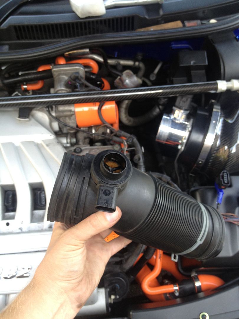

Hi what does this sensor actually do that's in the stock intake pipe if I was to remove it and just plug it in what would happen far as I can see its just for the breather system
Reason I'm asking as I'm removing the pipe to put a custom one there

In really cold climates, it's a heater that stops the water freezing onto the throttle blade. Breather fumes are mostly watery until the engine gets up to temp. It might even be a dummy connection. It is on UK VR6s. When starting the car from cold, pull the plug and see if there is a voltage across it. If there isn't, bin it. Or simply pull it, start the car and then check VCDS for any errors. No error, it's not important!

Good plan
ill bust the fluke out now
