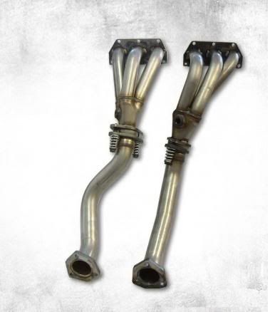

Do you have the new style Millteks with the flexi section in the secondaries (as per my pic below) and solid bolted connections between the upper and lower sections as as opposed to the eartlier type with the soft o-ring connectors (or watever they are really called) and sprung bolted connections holding the primaries and secondaries together? I ask as I didn't get gaskets and was wondering if this is the norm?

No I have the dub power manifolds which are a copy basically of the early style millteks and 100quid cheaper. These came with graphite type seals on the spring joints. If you have the new manifolds I would of thought they would come with gaskets for the middle botled sections on them.

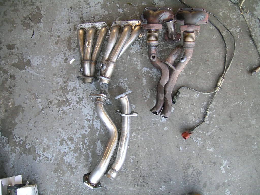

I had these fitted a few years ago..
Easier to chop the old stuff out.
Take as much off as you can and tie wrap pipes out of the way to give as much access as possible.
PITA if your doing it by yourself and a ramp helps a lot..
Quite tight..
Milly Cats are quite big..
Milly mid and rear..
I replaced all 4 lambdas as I didn't want to take the chance on breaking one and a good excuse to make the system tip top.
Good luck with the swap.
Steve
