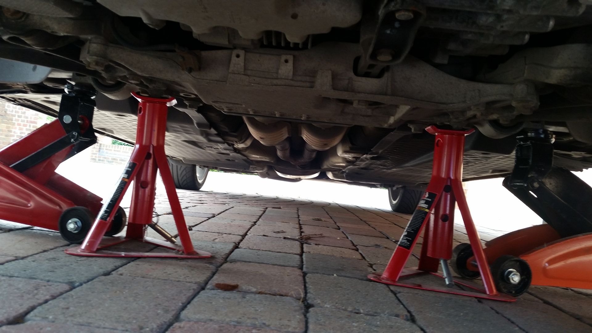

Get the car jacked up and on axle stands
!!! use the T20 to remove the 8 screws 4 either side of the under try remove this before anything else !!!

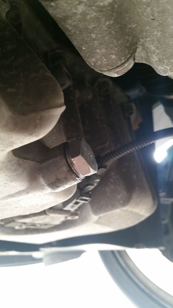

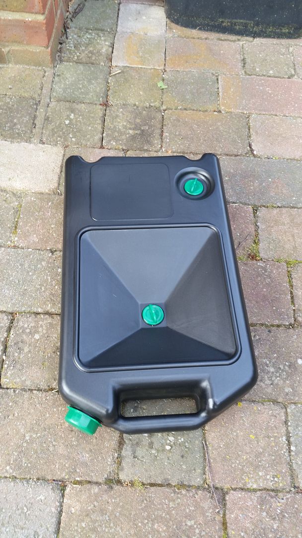

place oil drain pan under the sump plug area (preferably not to windy a day) then undo the sump plug, try not to drop it into the drain pan.
once the sump is fully drained use the new sump plug and tighten to the correct torque 30Nm

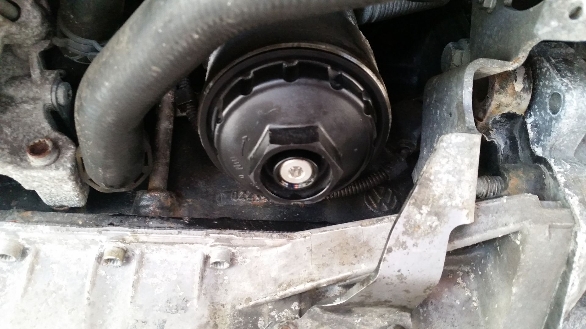

now move the drain pan to under the oil filter housing and using a 6mm Allen key remove the drain plug to drain the contents of the filter housing (silver plug in the middle of the black hexagon)
now your supposed to replace the o ring on this but frequently like mine was thanks VW it was gouged up so had to replace the whole plug as i'll be doing my own oil changes form now on.
so once the oil has drained pop it back in hand tight for a bit, now using the 36mm socket remove the filter housing cover and let it go into the drain pan (you might want to pop some card down on your drive just in case you drop it or they'll be oil everywhere.
remove the old element from the housing cover and clean all the parts of oil
replace the housing covers o ring form the new filter box, i comes with it.
place the new element in the housing and wipe some oil around the new o ring so it doesn't snag when tightening up.
replace the o ring in the little drain plug (if your not renewing the plug) and do everything up to the torques specified above.

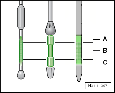

For dipstick as illustrated:
A - Oil must not be replenished.
B - Oil can be replenished up to area -A-.
C - Oil must be replenished. The oil level must then be at least in the upper third of the measuring area -B-.
- If oil level is above marking -A-, drain or extract excess oil to prevent damage to catalytic converter. - If oil level is below marking -C-, replenish oil to marking -A-. Oil specification
add the extra 500ml of oil as necessary then if your happy start the engine wait for the rattle to stop as the oil starts to pump round check for leaks after say 5 mins of running.

5,492 Posts
Does anyone know if u can buy the metal drain part (the silver bit) of the oil filter housing?
My one has been rounded off by vw, so everytime I change oil, I just get covered in oil when I undo the entire oil housing cap...
1,022 Posts
bit of a late reply, but yes you can mate.
£15.20 from VW though lol
or £36 for the hole bottom cover which includes the metal plug.
Prices slightly less from TPS
5,492 Posts
Thanks Ash,
if you dont mind, could you post up the part numbers too?
1,022 Posts
Sure,
Plug is 071 115 434
and the cap inc bolt is 071 115 433
