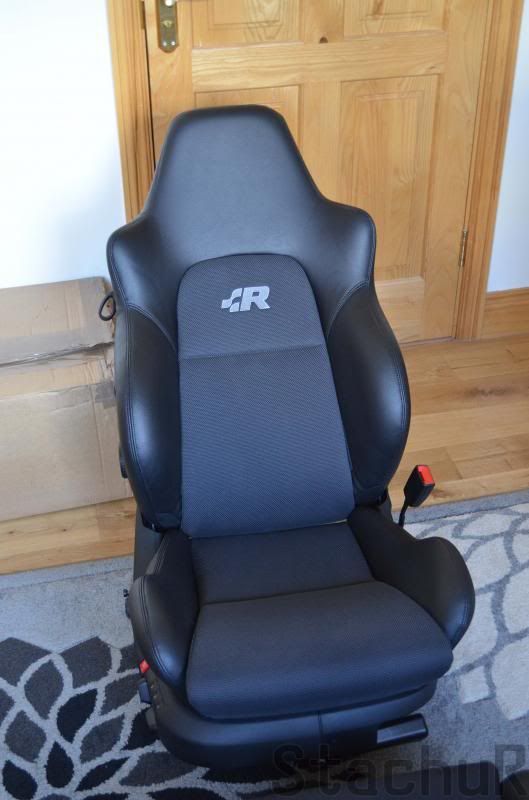

I started a thread while ago about my Koenig electric seat conversion. This is them now all done and ready to go inside the car.
I converted from full leather to gorgeous anthracite inserts as I think they are awesome! The rear bench has been fitted with those as well and is already fitted inside the car.
The seats are fully electric with memory function. The mirror dip when in reverse also works nicely.
As far as I'm aware there isn't many of these done worldwide, so in a way I'm delighted with mine

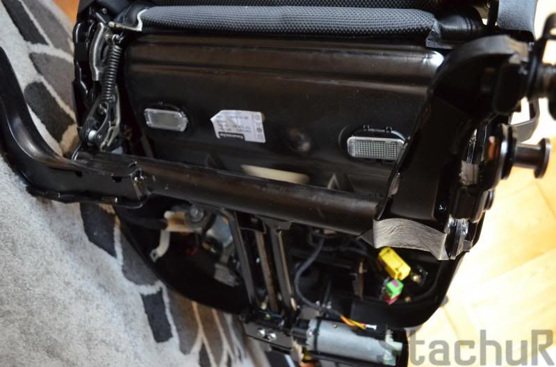

And this is how the electric seats wiring loom was being integrated

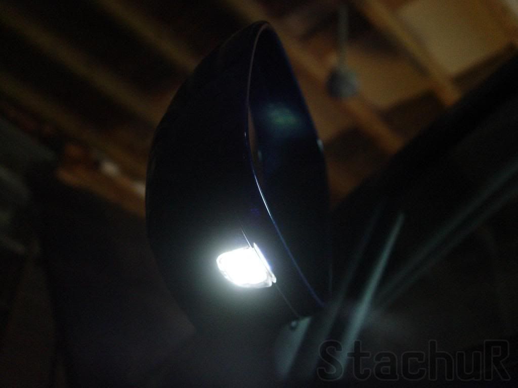

Next are electric/heated/folding/memory OEM stubby mirrors with OEM LED puddle lights
The puddle lights came from Skoda Superb, I had to modify the plastic trim underneath the mirror to accomplish this:

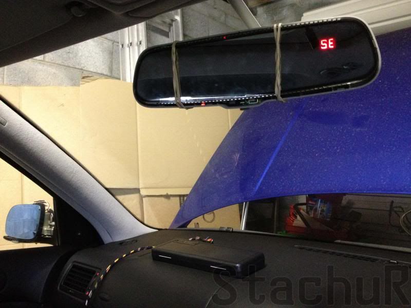

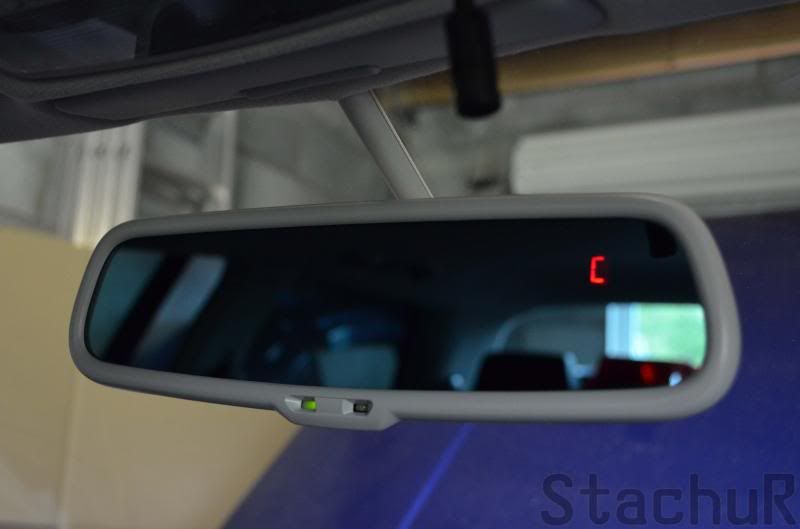

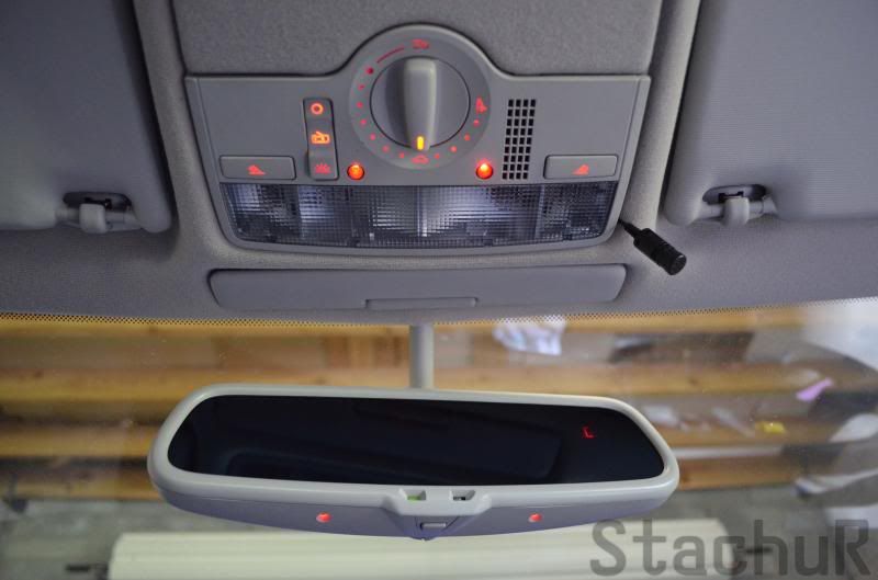

Quick iPhone shot of compass mirror successfully calibrated and working inside Passat B5 mirror with W8 Leds mounted.
The black box on the dash its where the hardware is mounted incl. compass module.

Most US Audis have them fitted. I really wanted one too but with a twist. None of those come with red ambient lights (like W8 light) so I integrated one into it. Not fully tho, hence the black box seen there as there isn't enough room to mount it all inside and have ambient lights and auto dimming on/off switch.
I'll try to make decent pics tomorrow.
The compass basically tells you which direction you are heading
i have a tiny switch for compass on/off/calibration mounted too

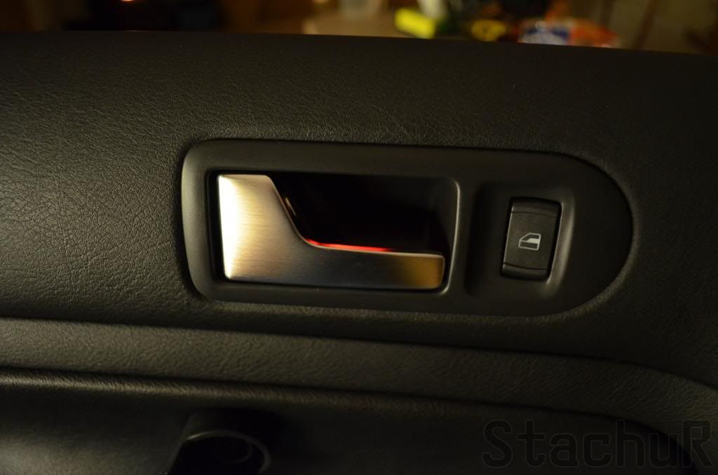

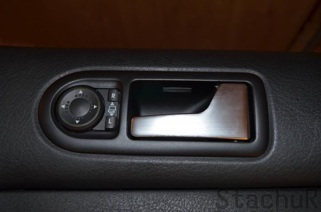

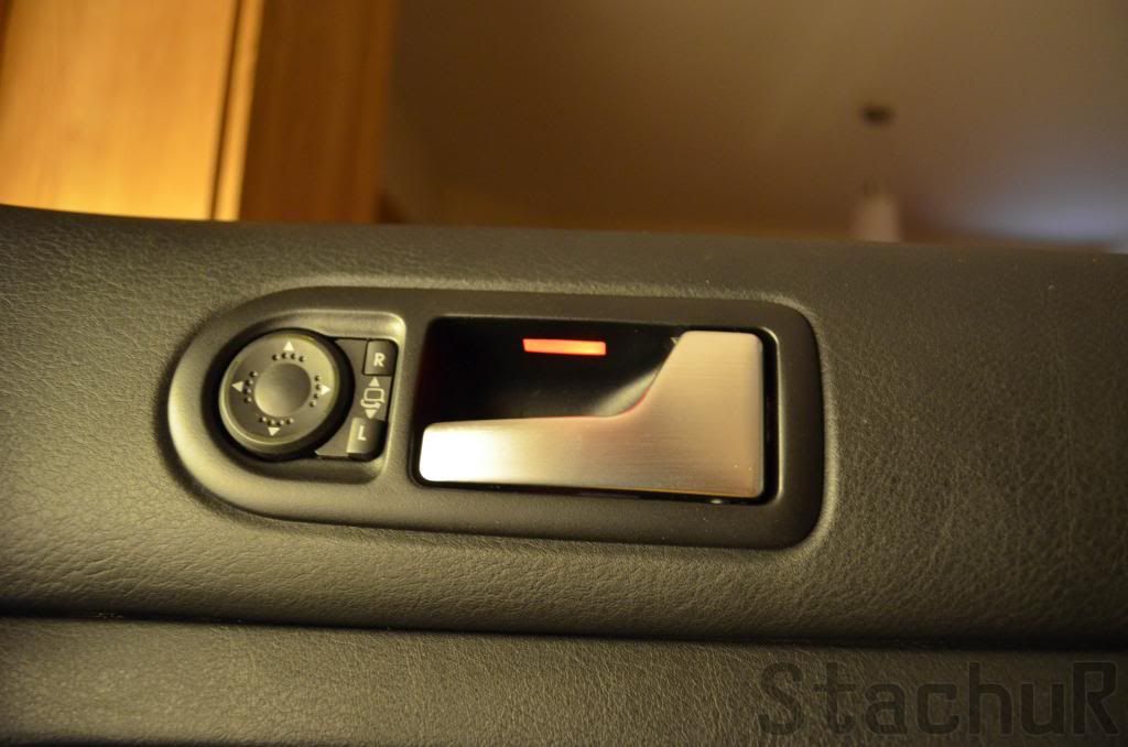

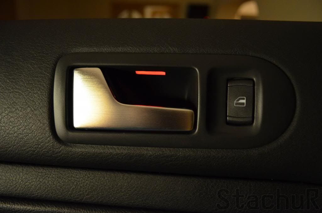

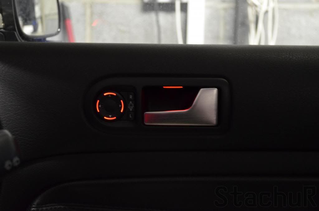

"Audi Ambient Lights in door handles"
These took a while to do as I didn't have much room for error as I have the early Passat door handle fitted. Those really look good!

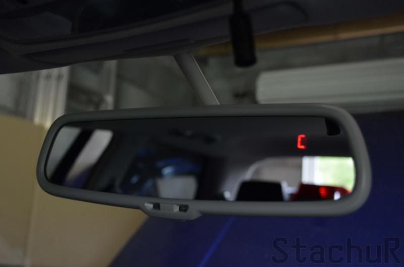

Finished my compass mirror today, it just needs to be calibrated again thats why its displaying 'C'.
Also fitted red LED into the sunroof switch
Now I can control auto dimming too, where original mirror that comes in the mk4 R32s is on all the time.
Off:
On:
