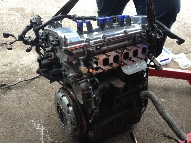

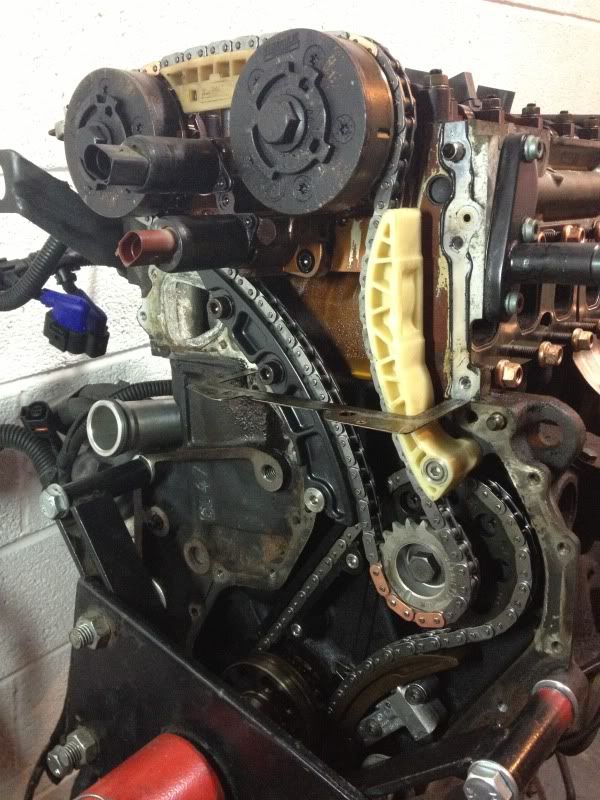

I gave the R32 engine an overhaul in my garage. This involved changing the chains/tensioners, oil/water pump, refurbed alternator, new aux belt, new thermostat, metal crack pipe and new gaskets all round. Also removed the SAI (well it wasn't with the engine) so got Si to make me up an adaptor to remove the SAI valve on the back of the head.

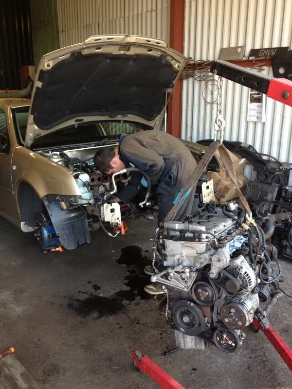

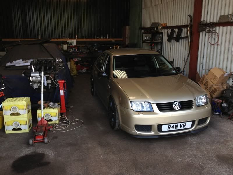

Took the car down to Monkey & Jimbo's unit to get started on the engine conversion:
Engine out (thanks to Monkey)

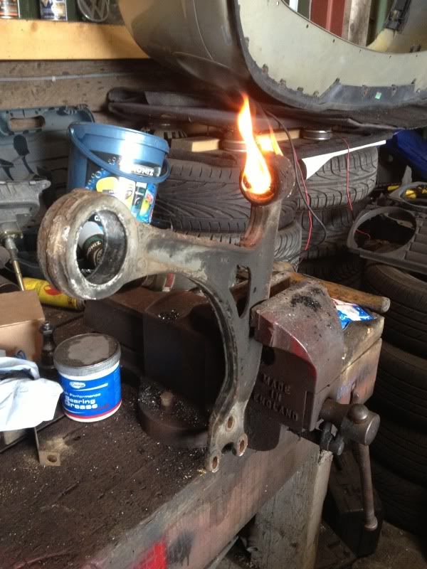

Wishbone preparation for poly bushes and DEFCON inserts

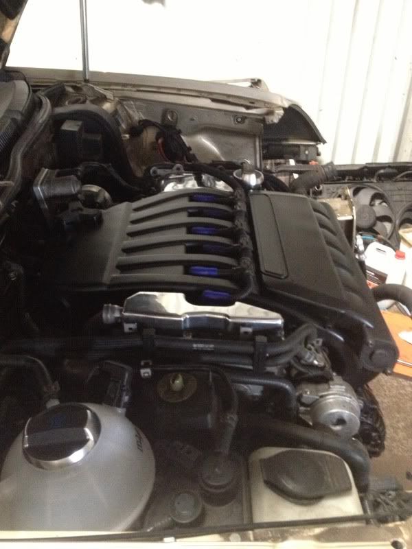

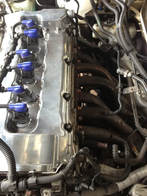

Gave the inlet a lick of paint

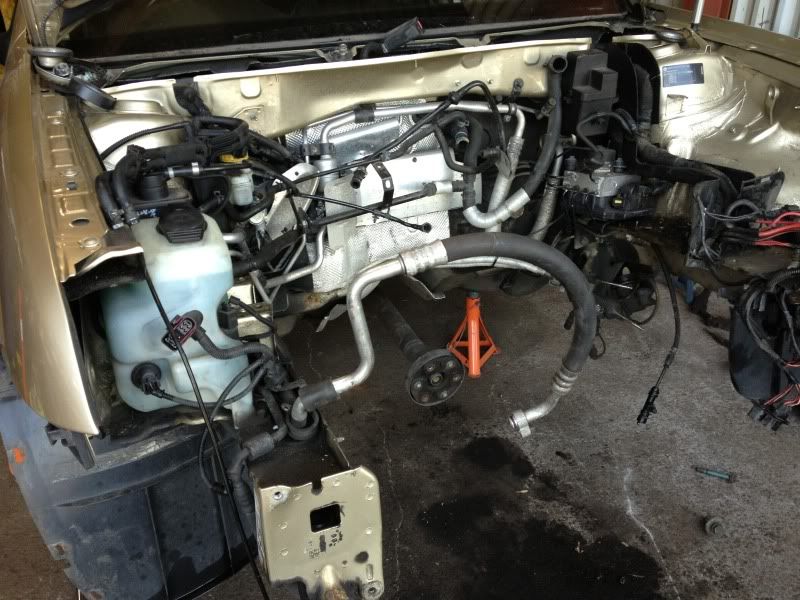

All fitted up with new expansion tank and Porsche water/oil caps

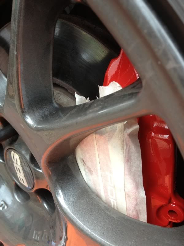

Got some Porsche 996 Turbo calipers, 2 piece disks and Ferrodo DS2500 pads to put on but they wouldn't clear my BBS CH's without spacers and that made them poke too much :-(
So had to get some new temporary wheels to clear them

What a beauty, loving the polished valve cover with the black manifold over, really nice touch!
Thanks! TBH it looks a lot better than I was expecting, have been trying to find another rocker cover so I can get it powder coated satin black, but won't bother now
