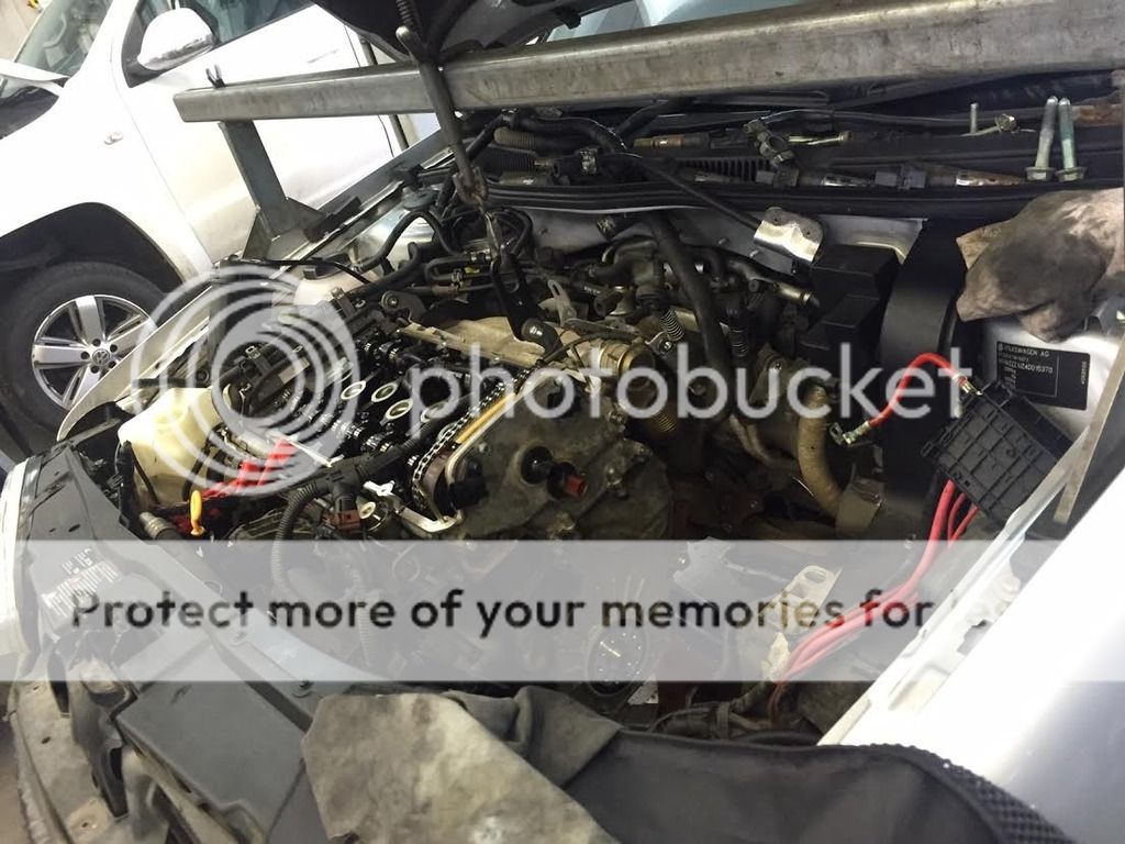

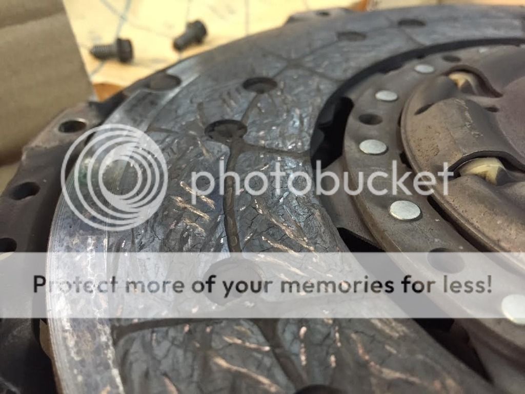

Had the clutch + flywheel done, along with new chains, rails, tensioners, sprockets.
Clutch is fairly fierce but i'm assuming that's expected with any new clutch?
All in all though, its so much nicer to drive, certainly improved the throttle response and pulls so much better through the gears.
Unfortunately I didn't get chain readings beforehand but there was a big visible difference between the old tensioner and the new one so the chain had stretched a fair bit.
The chain noise from the engine has all but gone aswell, so really glad I had it done.
And from the pic below, its safe to say the clutch was due :P
Going back together
