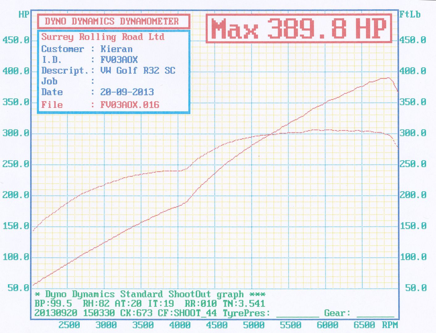

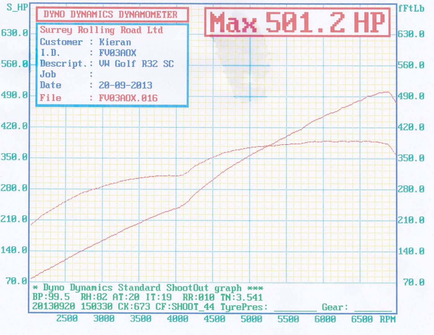

Thought I should chime in on this,
Might be worth adding a 4.5-4bar FPR to the list £20-60.
To answer some of Corrador32’s questions
Mine is fitted with a 75mm pulley, making just under 20psi. Similar setup to Nige, only engine mod was low comp pistons.
I think to get the 500 like mine the charger is being over spun by something like 12%, my old C30 was over spun buy 20-30% (I think) to get 474hp.
Off the top of my head positive boost starts at 3.5-4k rpmPosted Image

Kieran - I dont know if Im missing something simple, but whats the bottom RR printout for?
DBP R32 - Gone is the show, now is the go!
Kieran
Kieran
  • 388 posts
Brilliant, cheers! :)
Top is flywheel hp, Bottom is wheel hp. One is calculated from the other, can't remember which way round it is.

Ah, makes sense now! Cheers
