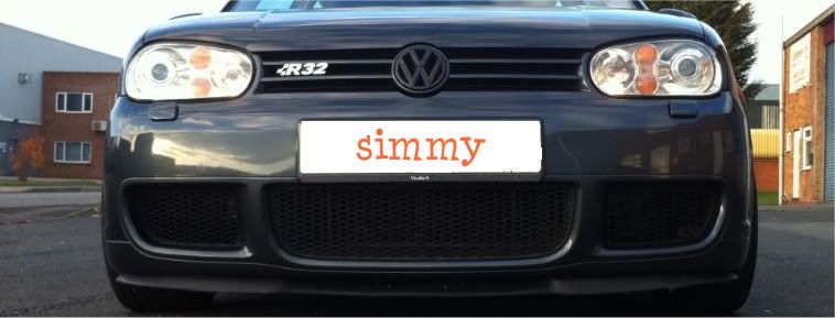

Back bumper looks odd cause its a R-line bumper but the middle section is missing
